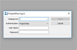

How do I disable the ProjectWise log in dialogue box (seen below) when launching OpenRoads Designer from desktop?

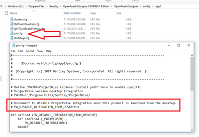

Find pw.cfg and open it. By default this file can be found here C:\Program Files\Bentley\OpenRoads Designer CONNECT Edition\OpenRoadsDesigner\config\appl
Uncomment line 14 from #PW_DISABLE_INTEGRATION_FROM_DESKTOP=1 to PW_DISABLE_INTEGRATION_FROM_DESKTOP=1.
Save file and close.
