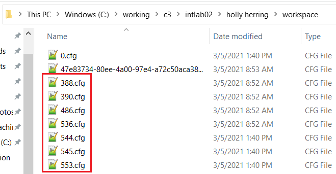

I need help interpreting my CSBs, but I do not have ProjectWise Admin rights. Where can I see how my CSBs are defined?
Answer:
  1. Go to your dms folder location.
  2. Open the folder titled workspace
  3. The 0.cfg starts everything and works to get the dgn loaded. It will not list a CSB. The CSBs in the example above are contained in the .cfgs boxed in red.
  4. 544.cfg is reviewed in the below video on how to interpret this cfg as a CSB.
