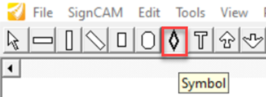

The pre-made U.S. Federal Recreational and Cultural Interest Area signs shown in the U.S. Federal 2004 Standard Highway Signs Manual and Federal 2012 Supplement to the 2004 Edition are available in OpenRoads SignCAD by selecting the Symbol icon on the toolbar.

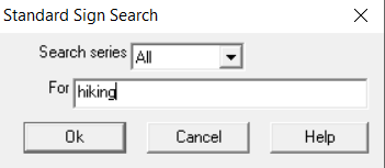

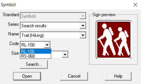

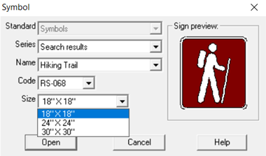

Press the Search button to enter a keyword or sign code.  All matching symbol signs will be displayed by browsing through the Code or Name fields. For example, a search using the keyword "hiking" will show the Trail (Hiking) RL-100 and Hiking Trail RS-068 signs. Once the sign is selected, then the sizes available for that sign will be selectable from the Size field drop-down.
Press Open to place the sign on the workspace.  Pick View>Full Screen (<ctrl>A) to see the sign if it is not immediately visible.
