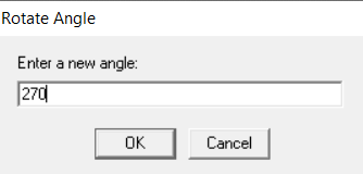

1) Pick Preferences>Rotate Angle. Enter the desired angle to rotate the text (ex: 270) and press OK.

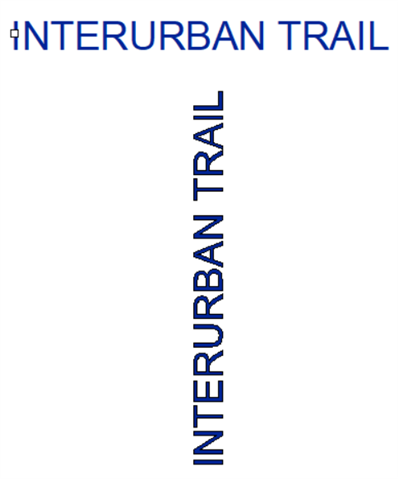

2) Select the text to rotate and pick SignCAM>Rotate Selected. This will duplicate the selected text and convert it to a rotated graphic.

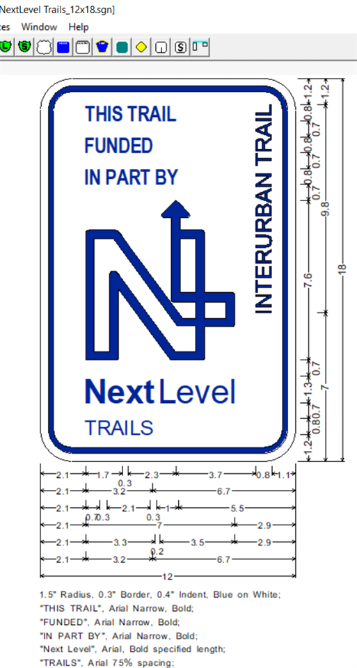

3) Add the rotated text to the sign panel and make the necessary adjustments to the object spacing and alignment. Save the file (File>Save As).
