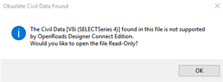

Can I bring my SS4/SS10 GEOPAK/InRoads/MX DGN files that contain civil model data (alignments/corridors/terrains) forward to begin working on it in OpenRoads Designer CONNECT Edition?
Answer:
Yes.  Please see this video that demonstrates the use of the Civil File Manager to upgrade DGN files:
https://bentleysystems.service-now.com/community?id=kb_article_view&sysparm_article=KB0018533

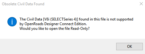

Obsolete Civil Data Found:  The Civil Data [V8i (SELECTSeries 4)] found in this file is not supported by OpenRoads Designer Connect Edition.  Would you like to open the file Read-Only?
