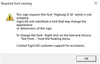

Required font missing
A "Required font missing" dialog box displays when opening or importing a sign in OpenRoads SignCAD.
Install the required font(s) into the C:\Windows\Fonts folder on the computer.  NOTE: A backup of the Highway fonts that come with OpenRoads SignCAD are located in the C:\OpenRoads SignCAD\Fonts folder.

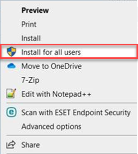

Locate the TTF (.ttf) file(s) for the missing font(s). Right-click on the TTF file(s), then select Install for all users from the menu that opens.
The missing font(s) will install into the C:\Windows\Fonts folder and can be used in OpenRoads SignCAD.
