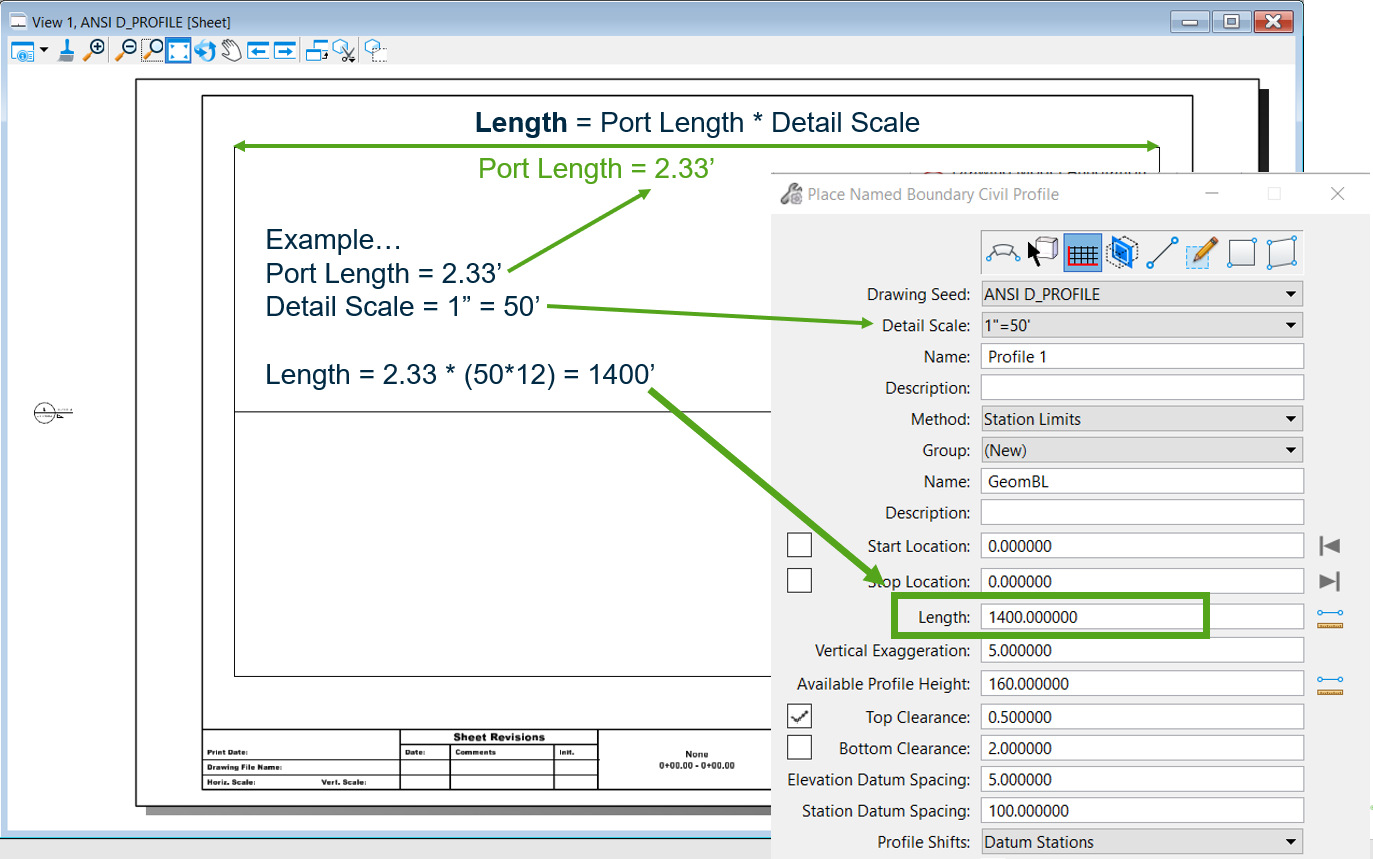

LENGTH - The maximum width or length of your profile is calculated from the width of the port within the sheet seed dgnlib sheet model. Take that length and multiply it by the detail scale to give you the maximum length.

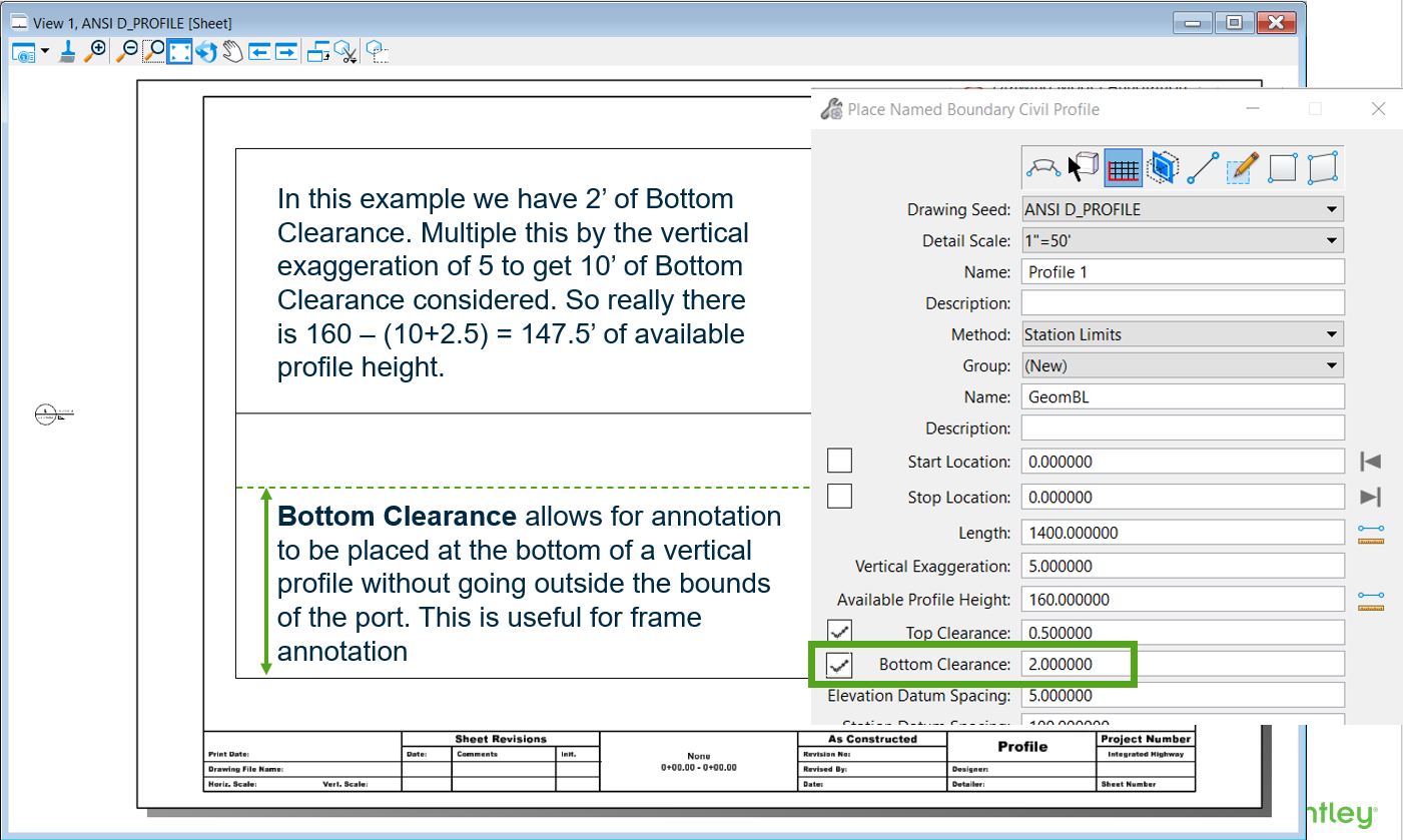

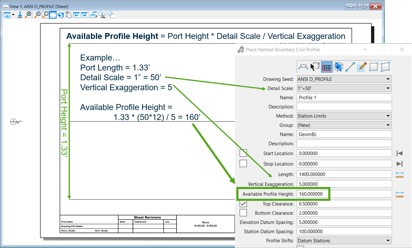

AVAILABLE PROFILE HEIGHT

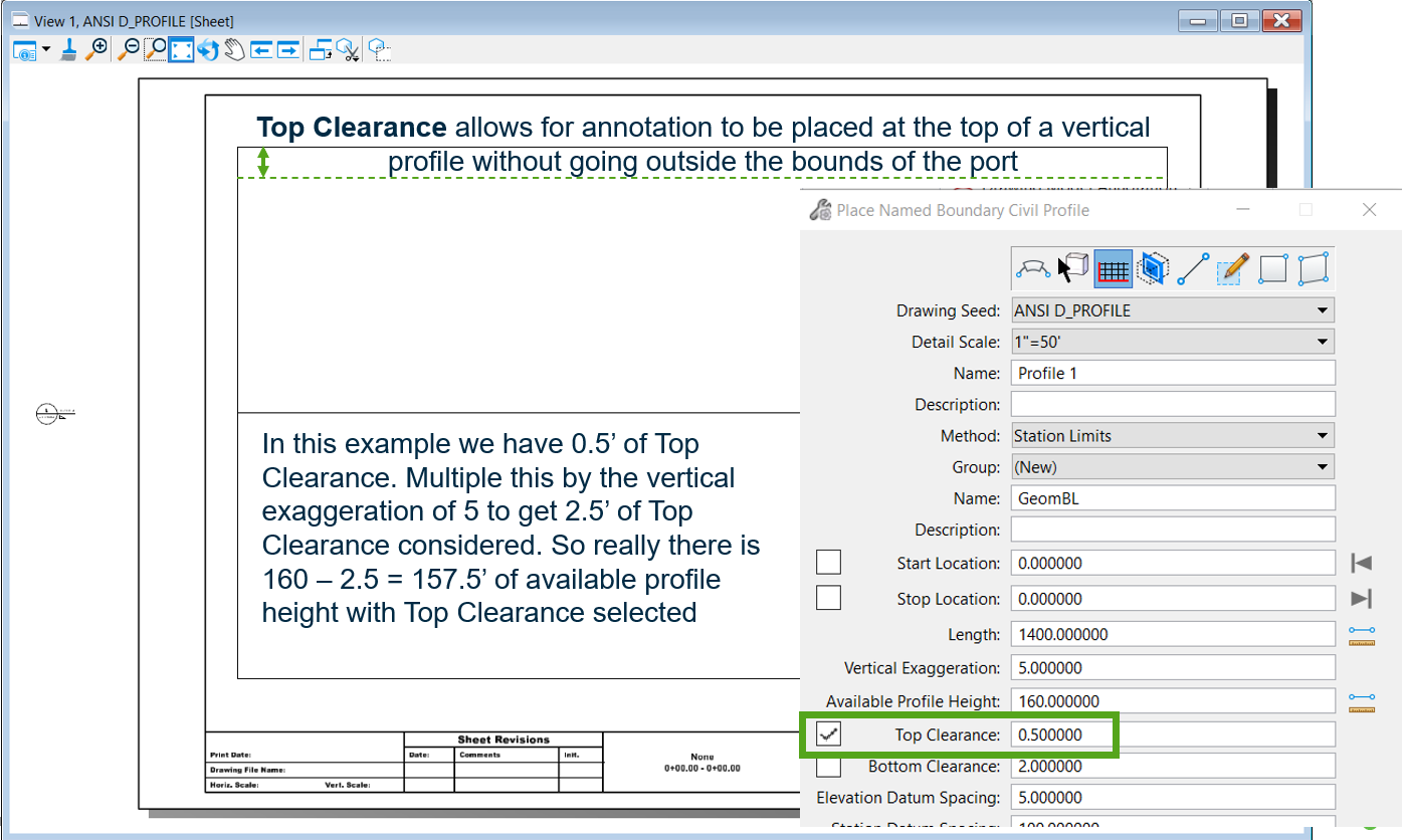

TOP CLEARANCE
BOTTOM CLEARANCE
