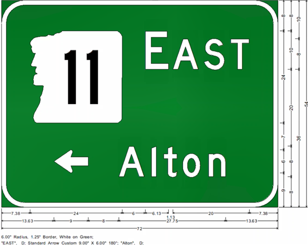

How do I left align objects in a sign within OpenRoads SignCAD?

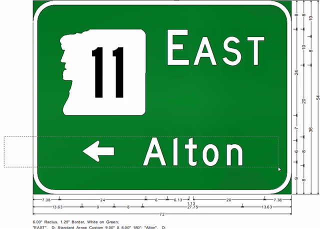

1) With the Select tool, window select the objects you want to left align (ex: arrow and Alton in the sign below).

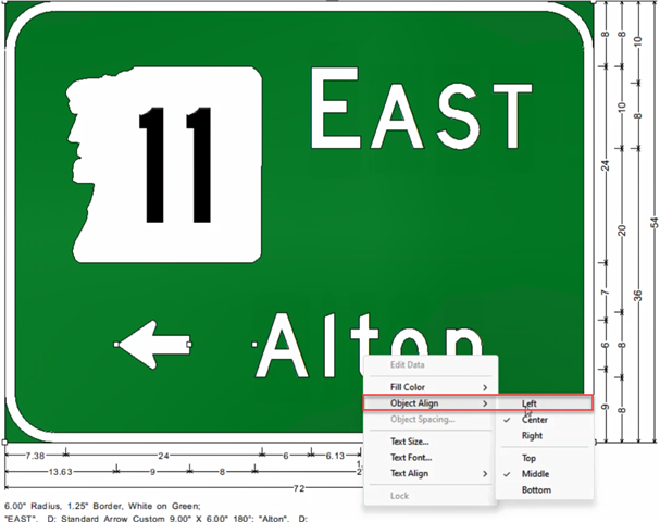

2) Right click and pick Object Align>Left from the floating menu.

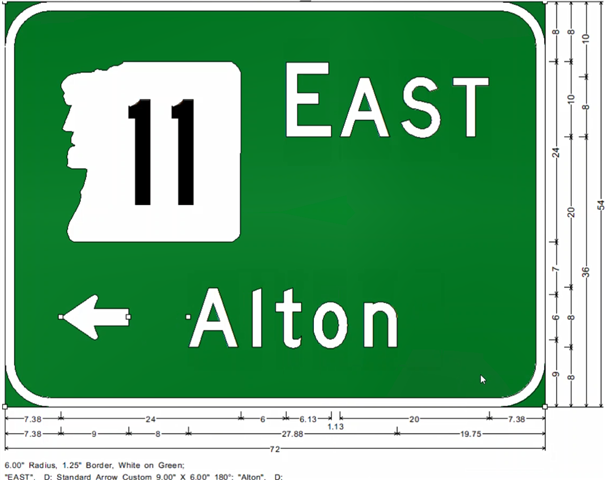

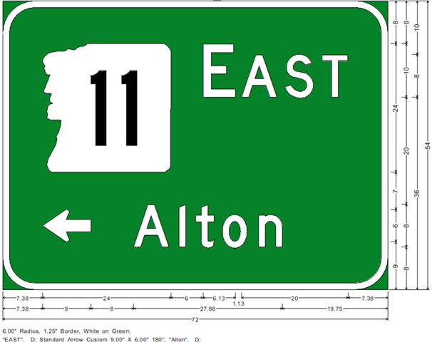

3) Left click on the workspace to de-select the objects. Save your changes (File>Save).
Here is a video that shows how to left align the arrow and Alton with the SH-11 shield in the sign.
