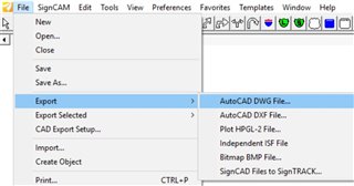

1) In OpenRoads SignCAD, pick File>CAD Export Setup. In the CAD Export Setup, choose the ACAD export options and press OK.
2) Pick File>Export and select either AutoCAD DWG File or AutoCAD DXF File. Select a sign in the file to use the Export Selected option.

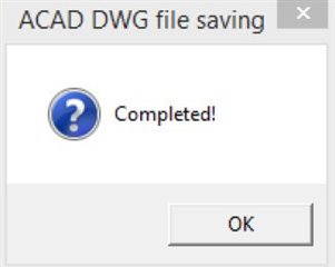

4) Press OK to the ACAD file saving dialog box.
