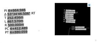

How to change the field text which comes with grey background while Annotating the Elements in OpenRoads Designer ?
Answer:
Go to File > Settings > User > Preferences > Text , toggle on "Hide Field Background" as shown in the below snapshot.
