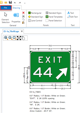

Step 1:  Open the SGN file.
a. Select Browse.
b. Select the SGN file and click Open.

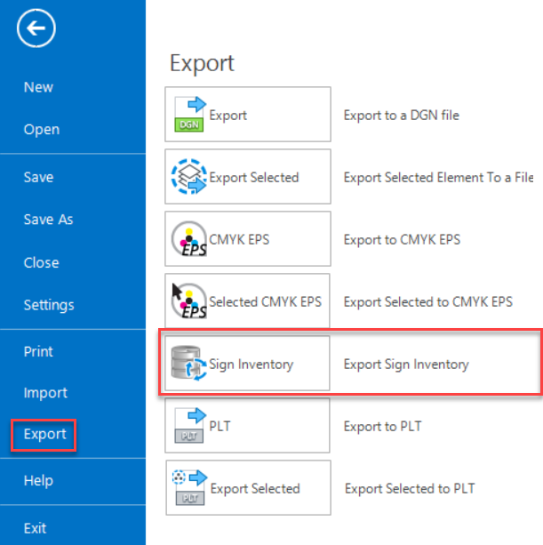

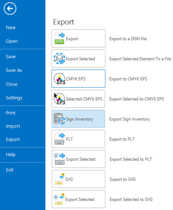

Step 2:  Pick the File tab to go to the Backstage. Select the Export > Sign Inventory option.

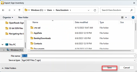

Step 3:  In the Export Sign Inventory dialog, browse to the location where you want to save the files (.sgn, .bmp & .json), enter a File name and press Save.
