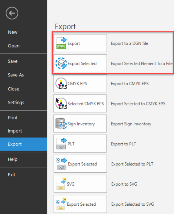

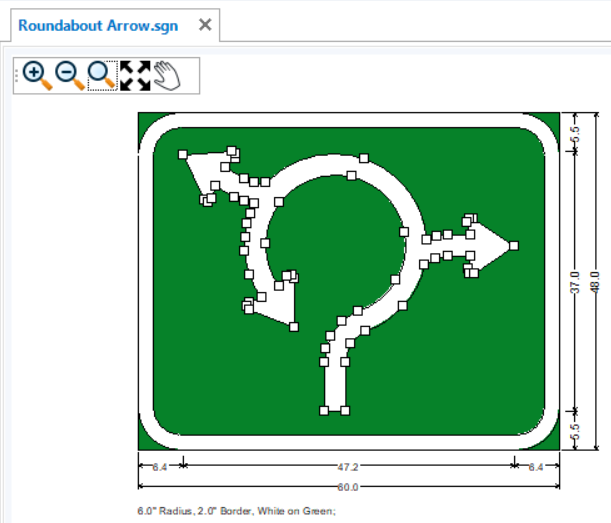

Step 1:  Select the file, sign or other element (arrow, graphic, etc.) to export.
Step 2:  Pick the File tab to go to the Backstage and pick Export. Select the Export or Export Selected option.

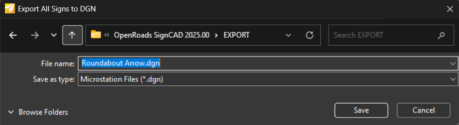

Step 3:  In the Export to DGN dialog, browse to the location where you want to save the DGN file, enter a File name and press Save. The DGN file will be saved into the Export Directory specified in the Settings.
Example default location: C:\Users\UserName\AppData\Local\Bentley\OpenRoads SignCAD 2025.00\EXPORT

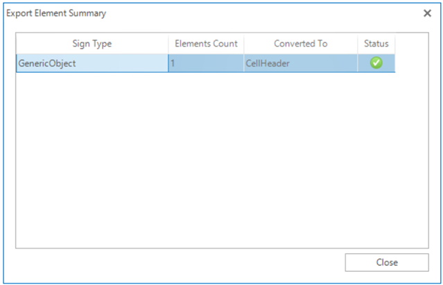

Step 4: View the Export Element Summary and press Close.
