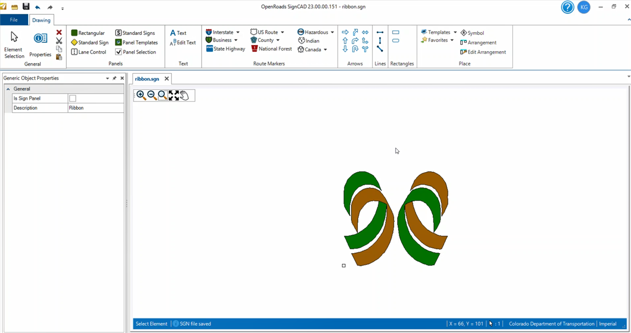

Step 1: In OpenRoad SignCAD, open a file that has an element, sign or arrangement that you want to add to Favorites.

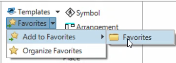

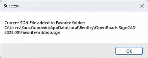

Step 2: Add to Favorites. Click on Favorites>Add to Favorites>Favorites. A success message will display letting you know that the Favorite has been added. Press OK to close the message dialog.

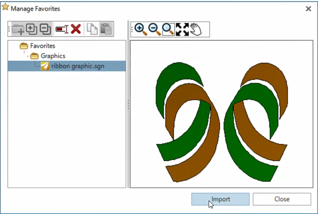

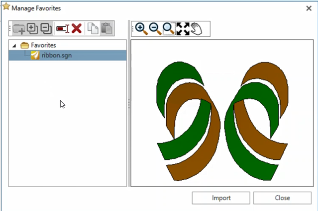

Step 2:  Organize Favorites. Click on Favorites>Organize Favorites to display the Manage Favorites dialog. Select the SGN file (ex: ribbon.sgn) to see the preview. Options for organizing saved Favorites from left to right include: new folder, expand, collapse, rename, delete, copy and paste. Files can also be dragged into folders.

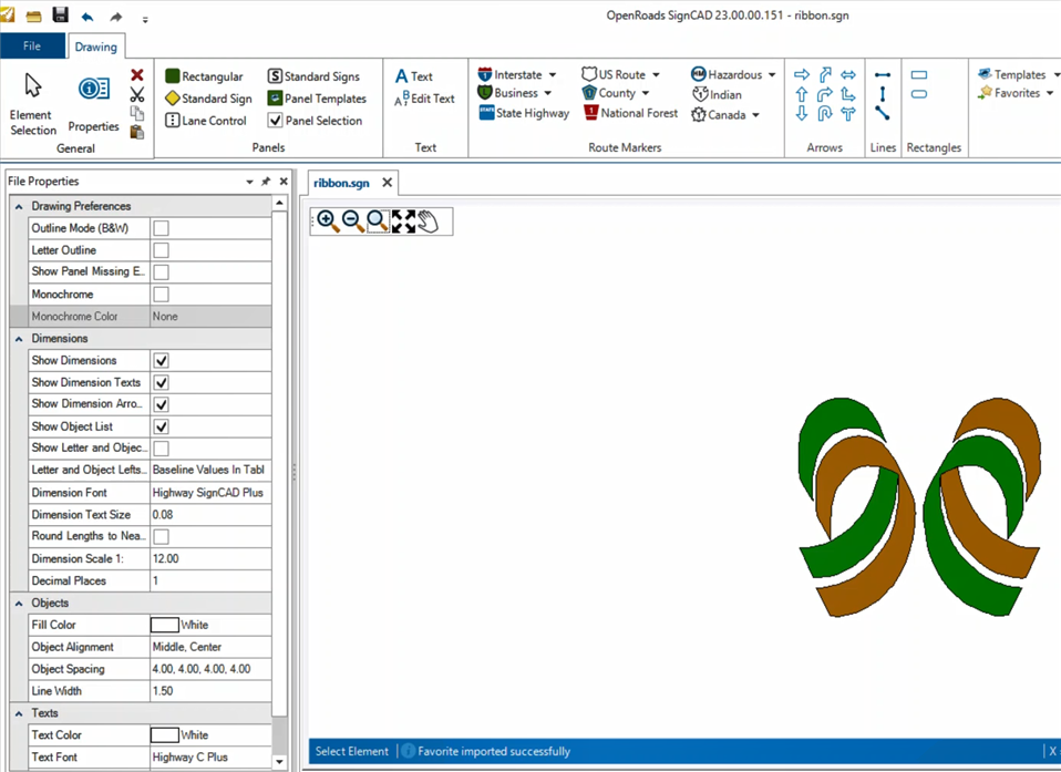

Step 4: Place a Favorite. Have the sign file active that you want to place the Favorite in and click on Favorites>Organize Favorites. Select one of the saved Favorites and click on Import. Left-click to place the Favorite on the workspace.
