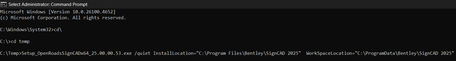

The instructions below describe how-to do a silent install of OpenRoads SignCAD.
OpenRoads SignCAD can be installed silently using Setup_OpenRoadsSignCADx64_25.00.00.53.exe /quiet in the Administrator Command Prompt.
To install the product and/or the workspace silently at a specific location, set the InstallLocation to the desired install location of the product and WorkSpaceLocation to the desired install location of the workspace; these variable names are case sensitive. The directory locations should be in quotes as shown in the example below.
Setup_OpenRoadsSignCADx64_25.00.00.53.exe  /quiet InstallLocation="C:\Program Files\Bentley\SignCAD 2025"  WorkSpaceLocation="C:\ProgramData\Bentley\SignCAD 2025"
