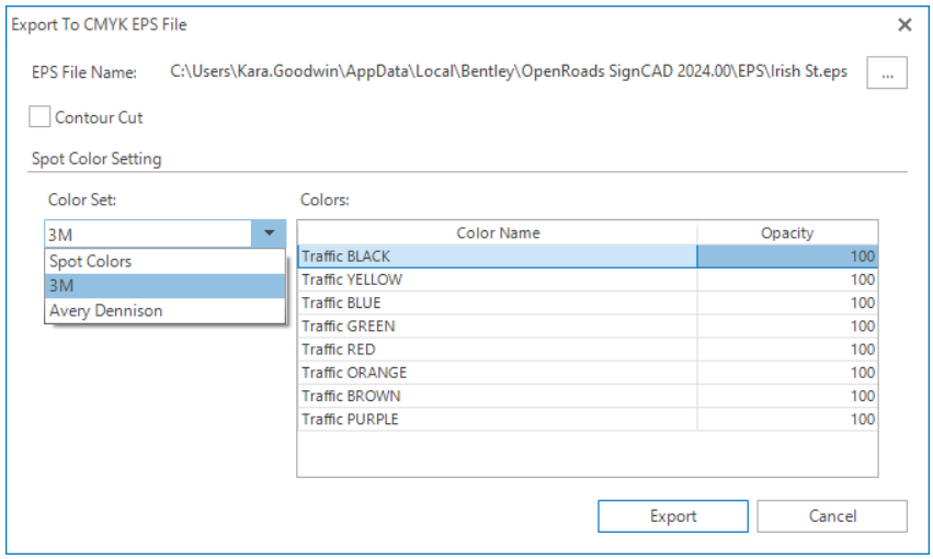

The instructions and video below show how-to Export to CMYK EPS for digital printing or cutting.

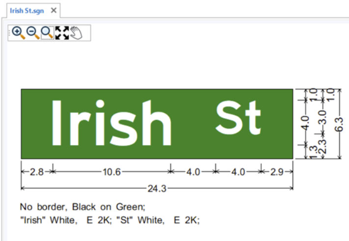

Step 1: Select the file, sign or other element (arrow, graphic, etc.) to export.

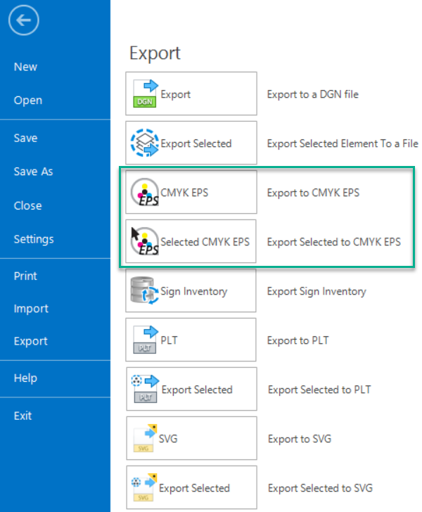

Step 2: Pick the File tab to go to the Backstage and pick Export. Select the CMYK EPS or Selected CMYK EPS option.

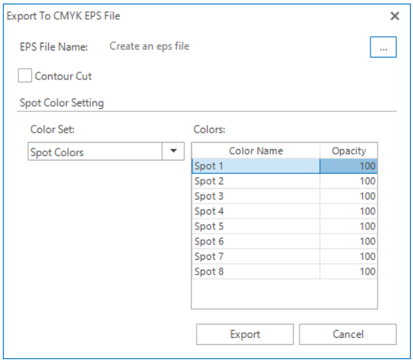

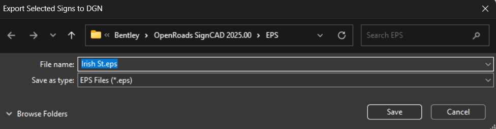

Step 3: In the Export to CMYK EPS File dialog, press the button with the three dots to the right of the EPS File Name, edit the File name and press Save.
Step 4: In the Export To CMYK EPS File dialog, select the desired settings and press Export to generate the EPS file.
For Printing: Select the Color Set to use from the drop-down menu and change the Opacity values if desired. If you would like a color used in the sign to be non-printing, then change the Opacity for that color to 0.
For Cutting: Check the Contour Cut box before exporting.

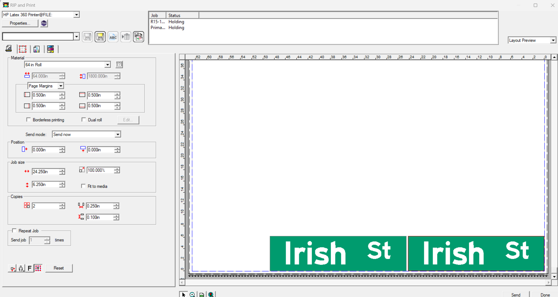

Step 5: Bring the saved EPS file into your printer's RIP software to print the sign or your cutter control software to cut the sign.
