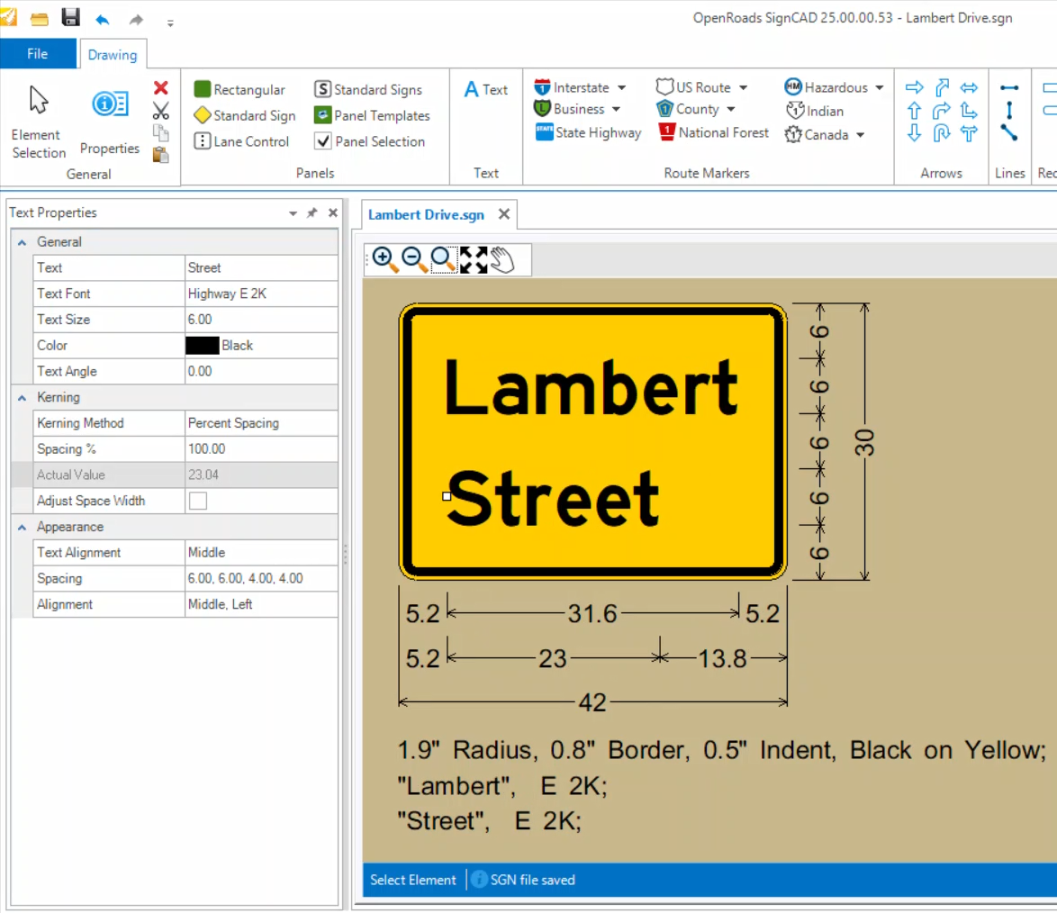

2) Text Properties
Placed text can be selected and edited from the Text Properties. Pick Properties and then select the text to edit. Click into the Text field to type new text (ex: Street). Adjust other text settings like font, size, color, angle, Kerning and appearance from within the text properties.

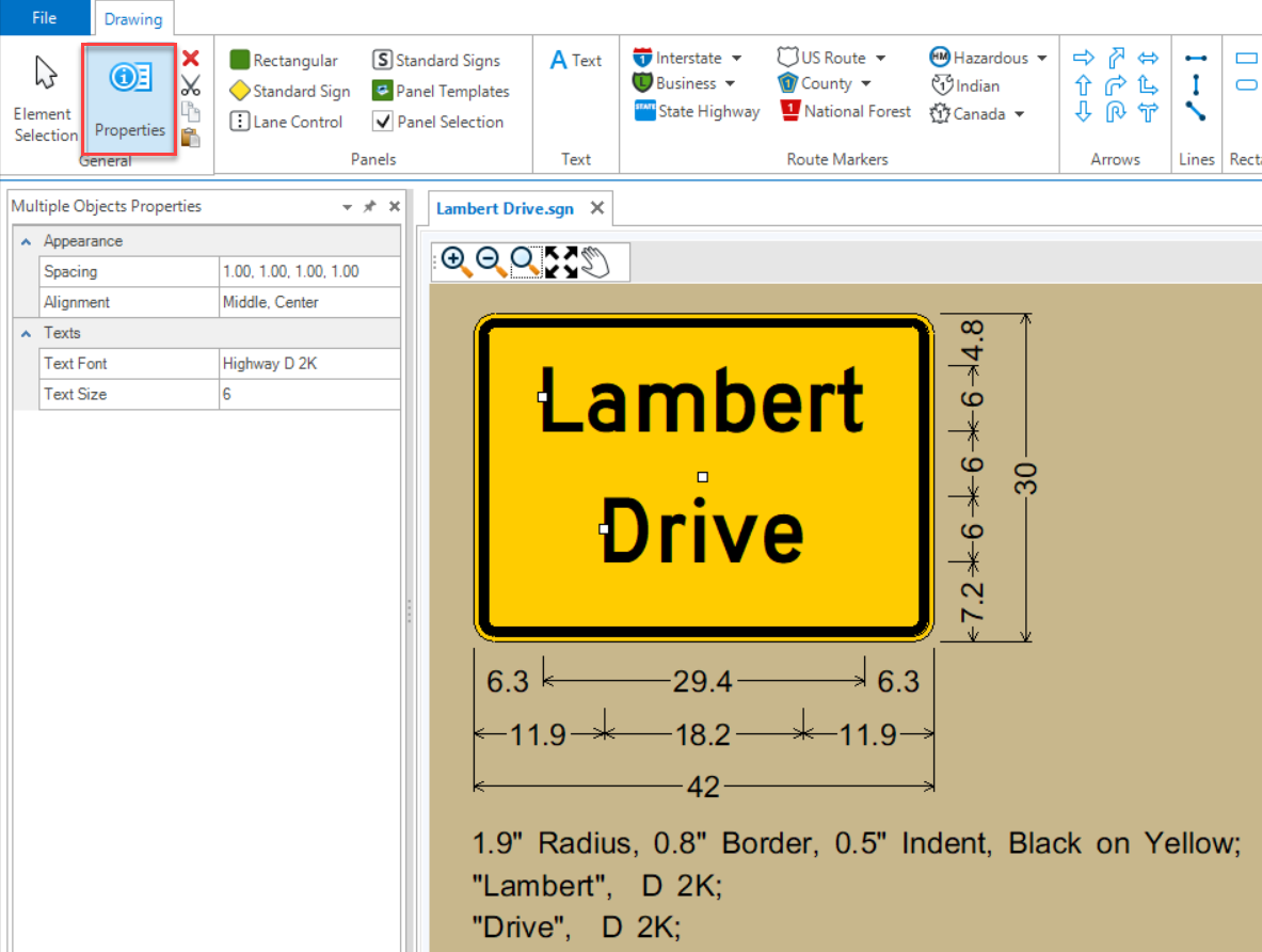

3) Multiple Objects Properties
To edit multiple text, pick Properties and then window-select the legend. In the Multiple Objects Properties, change the spacing, alignment, font and/or size for the selected legend.
