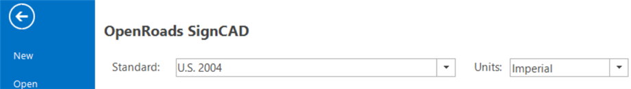

Step 1: Select Standard: U.S. 2004 and Units: Imperial and create a new file. See Selecting a Standard & Creating a New File - OpenRoads | OpenSite Wiki - OpenRoads | OpenSite - Bentley Communities.

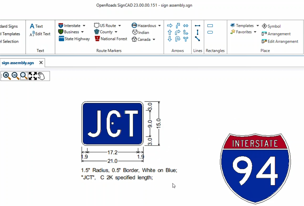

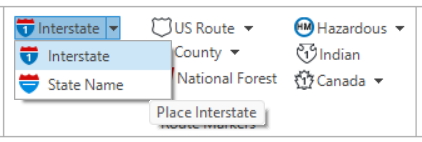

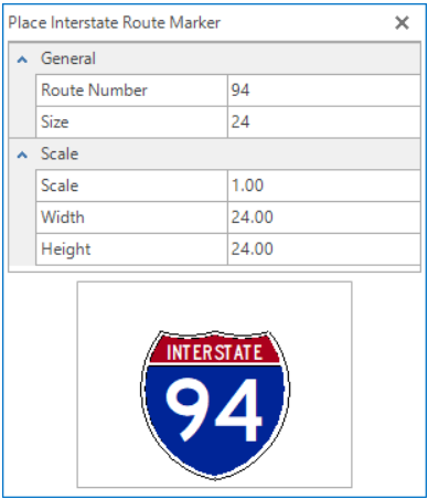

Step 2: Place the Interstate route marker. See Placing Route Markers - OpenRoads | OpenSite Wiki - OpenRoads | OpenSite - Bentley Communities.

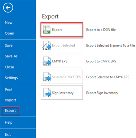

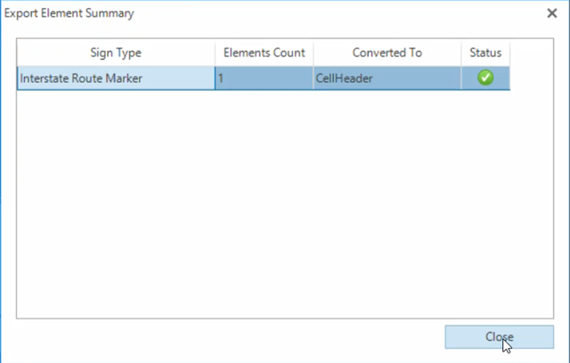

Step 3: Export the Interstate Route Marker to DGN. See Export to DGN - OpenRoads | OpenSite Wiki - OpenRoads | OpenSite - Bentley Communities.

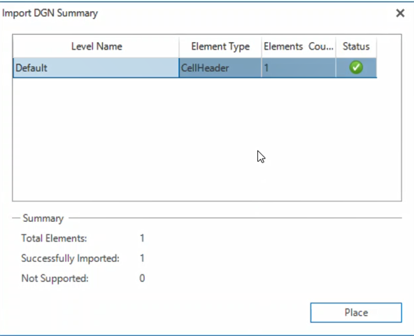

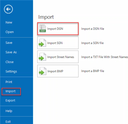

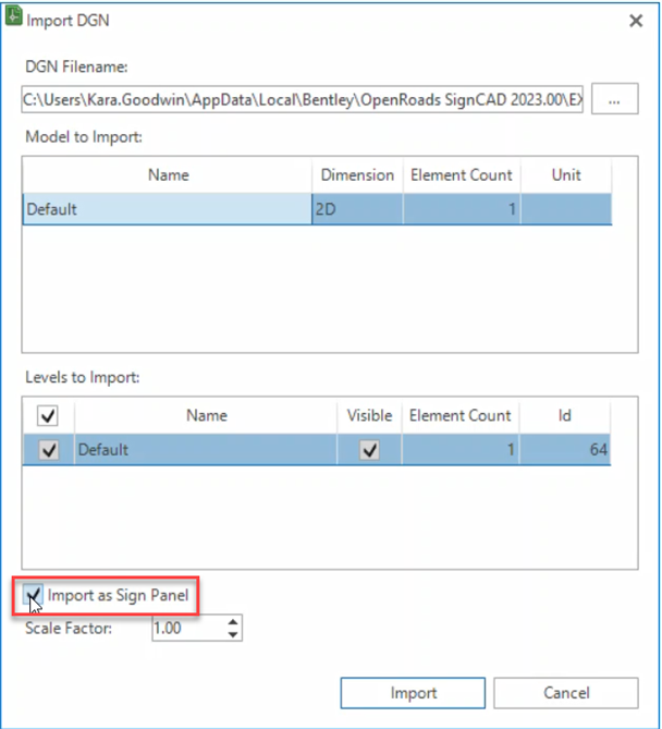

Step 4: Import the Route Marker DGN file. Select the Import as Sign Panel option in the Import DGN dialog. See Import DGN - OpenRoads | OpenSite Wiki - OpenRoads | OpenSite - Bentley Communities.

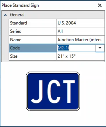

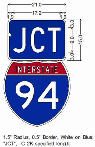

Step 5: Place the M2-1i Standard Sign. See Placing Standard Signs - OpenRoads | OpenSite Wiki - OpenRoads | OpenSite - Bentley Communities.
NOTE: Left-click in the Code field and type M2-1i.

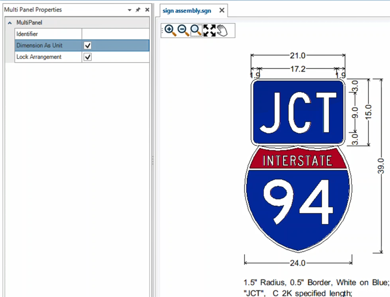

Step 6: Join the Interstate Route Marker and Junction Marker into a multi-panel. See Joining Panels to Create a Multi-panel - OpenRoads | OpenSite Wiki - OpenRoads | OpenSite - Bentley Communities.
