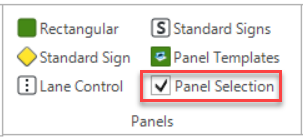

Step 1: Click on Panels>Panel Selection to turn it on. NOTE: The shortcut key <CTRL> can also be used to allow panel selection.

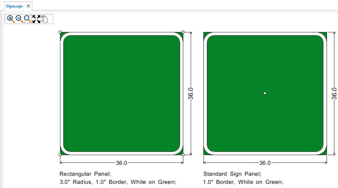

NOTE: Signs created using the Rectangular Panel will show the selection boxes on each of the panel corners. Signs created using the Standard Sign Panel will show the panel selection box in the middle of the panel.

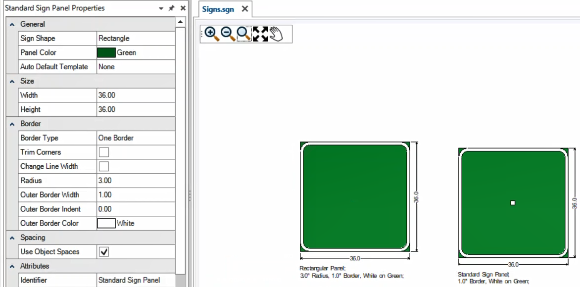

Step 5: To see the properties for the selected panel, pick Properties.
