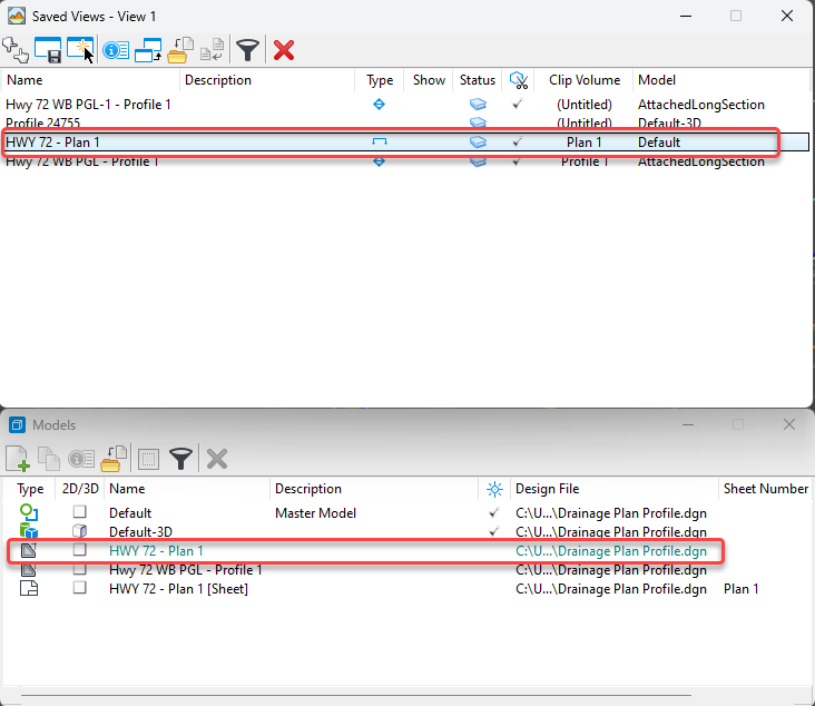

I used the Named Boundary tool to create Plan Sheets.  That tool creates a Drawing Model and Sheet Model for each of my sheets.  I want to label in the Drawing Model as recommended by Bentley.  However, I cannot place labels with the Civil Labeler in my Drawing Model.
Possible Solution:
When the software creates the Drawing Model and Sheet Model it will also create a Saved View for each Named Boundary.  In the image below the Saved Views dialog shows a Saved View named HWY 72 - Plan 1.  If the Saved View is or was deleted, then the Civil Labeler tool will not be able to create/place labels in the Drawing Model of the same name.

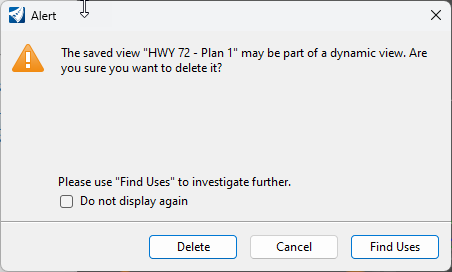

If you highlight the Saved View and select the Delete icon, you will receive an Alert dialog that lets you know it is part of a dynamic view.
If the Saved view is not there then you have to recreate the drawing from the Named Boundary.
