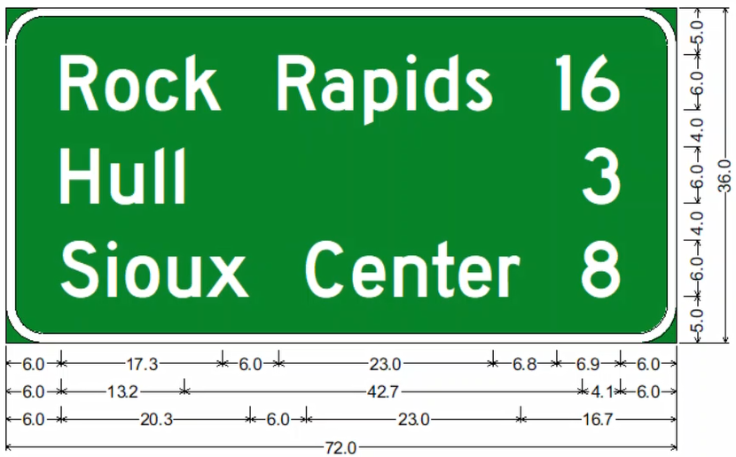

Introduction:  The videos below show how-to create a distance sign with three lines in OpenRoads SignCAD using two different methods.
Method 1: Creating the distance sign without a tabular arrangement.
Method 2: Creating the distance sign using a tabular arrangement.
