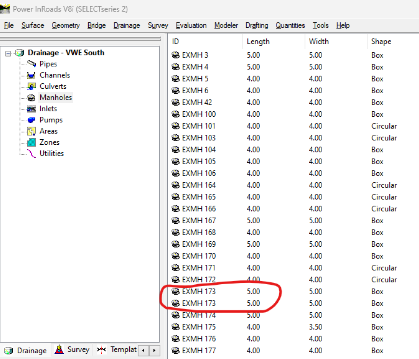

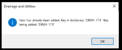

Question:
I go to Drainage & Utilities > Home > Model Import/Export > Import Utilities > Import InRoads, select the SDB to import and receive the message below. How do I resolve this?
Answer:
This is caused by duplicate drainage features, in this case manhole "EXMH 173", in the sdb file. This will need to be resolved in the sdb file prior to importing into OpenRoads.
