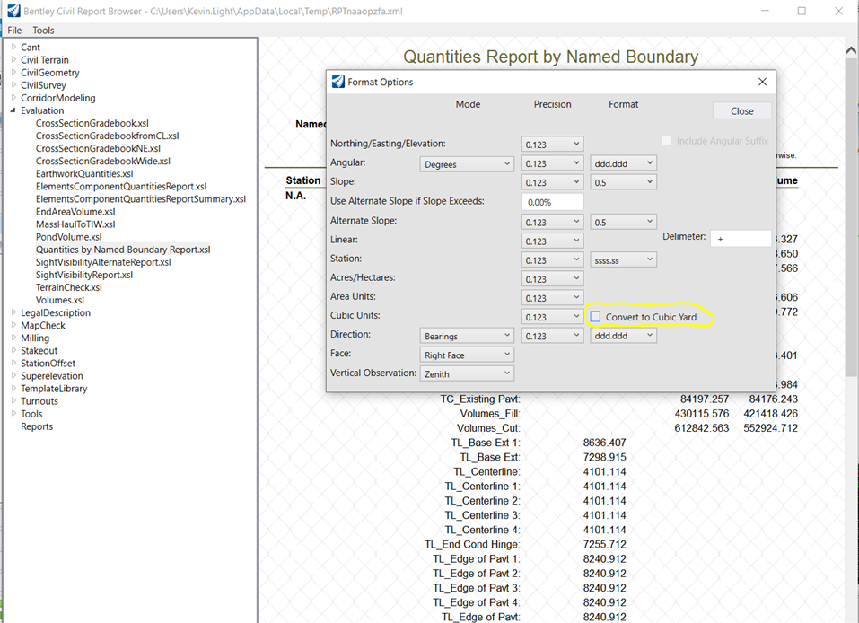

When a report is generated, the Bentley Civil Report Browser will appear.
In the Bentley Civil Report Browser, navigate to Tools and select Format Options.
In the Format Options dialog, select the toggle "Convert to Cubic Yard".
The Report will now display the Cubic Units as Cubic Yards rather than Cubic Feet.
