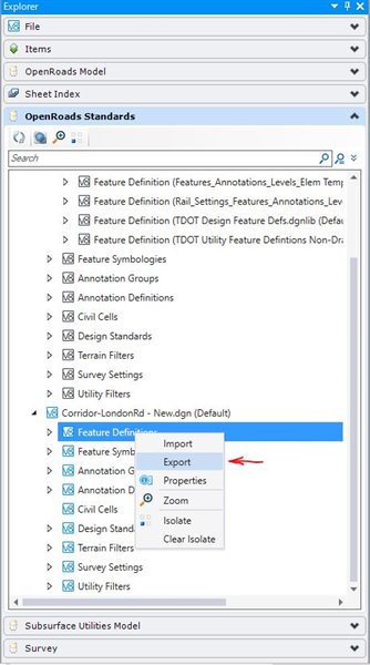

 In order to report on the Feature Definitions, you need to go to the Feature Definitions under the OpenRoads Standards in your dgnlib or active dgn file, right-click on the Feature Definitions category and select 'Export'.

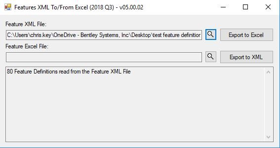

This will allow you to save an XML File.  Once the XML is saved, go to C:\ProgramData\Bentley\OpenRoads Designer CE\Configuration\Organization-Civil\Migration Utilities\Features Import Export and open the features_importexport_excel.exe file.  At the top, browse to the XML file you exported and select the 'Export to excel' option.

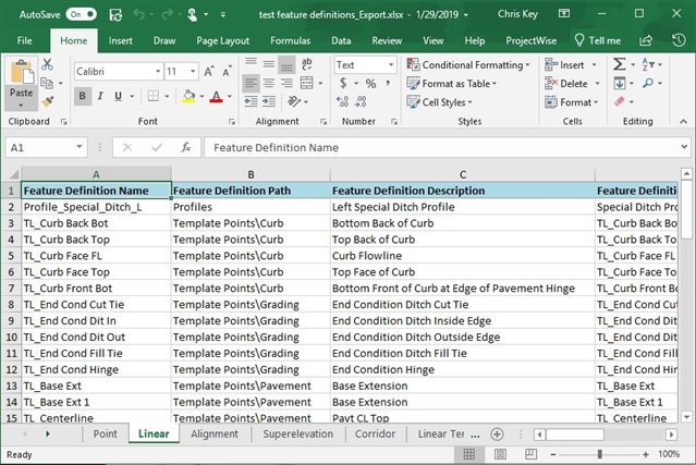

This will export an XLSX file which can be opened in Microsoft excel.  From Excel, you will see many tabs which categorize and sort the Feature Definitions.
