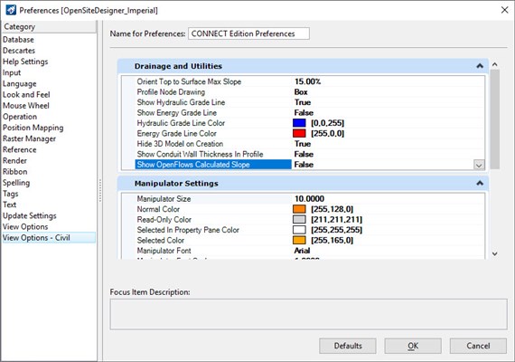

- The profile manipulator for conduit slope can now display the OpenFlows Calculated slope value, if this is selected in User Preferences>Drainage and Utilities.

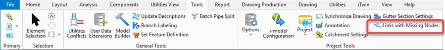

- Added a new dialog that displays the links with missing nodes in each database and allows you to delete some, or all, of the links. The key in for this is SUBSURFACE OPENLINKSMISSINGNODESDIALOG.
