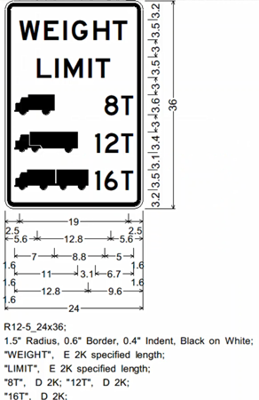

Question:
How do I edit a R12-5 standard sign in OpenRoads SignCAD to get the sign shown below?

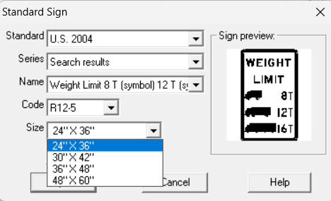

  1. In OpenRoads SignCAD, pick the U.S. 2004 standard.  Pick the Standard Signs icon   on the toolbar.  In the Standard Sign dialog box, search for R12-5 and pick the 24”x36” size.  Press Open. Here is a wiki with instructions for locating Standard Signs - OpenRoads | OpenSite Wiki - OpenRoads | OpenSite - Bentley Communities.
