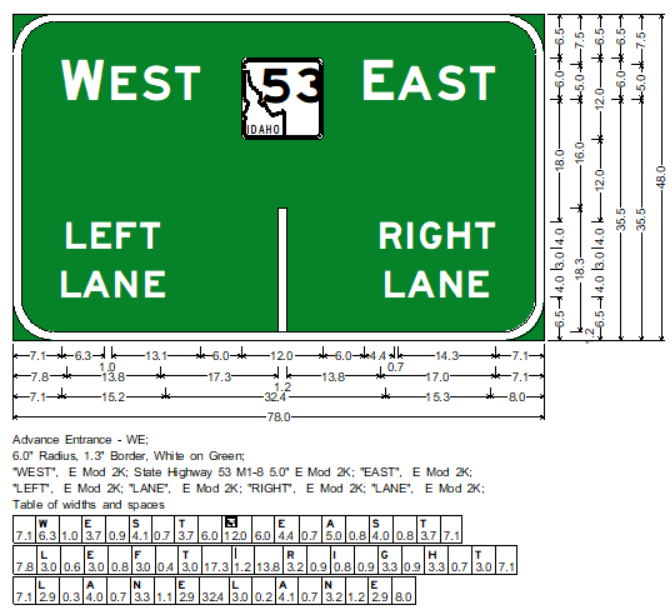

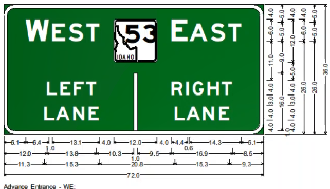

Introduction:  The video below shows how-to create an Advance Entrance Directional sign in OpenRoads SignCAD.
