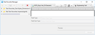

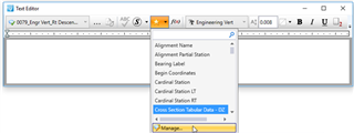

This video demonstrates using the Text Favorites Manager to copy a Text Favorite in Subsurface Utility Design and Analysis.
- Text Favorites Manager currently accessed through the Text Editor
- Currently restricted to the Civil Fields.
- Support for the "Element Properties" category slated for 2019.
- Provides a means to copy and paste between DGNLibs
