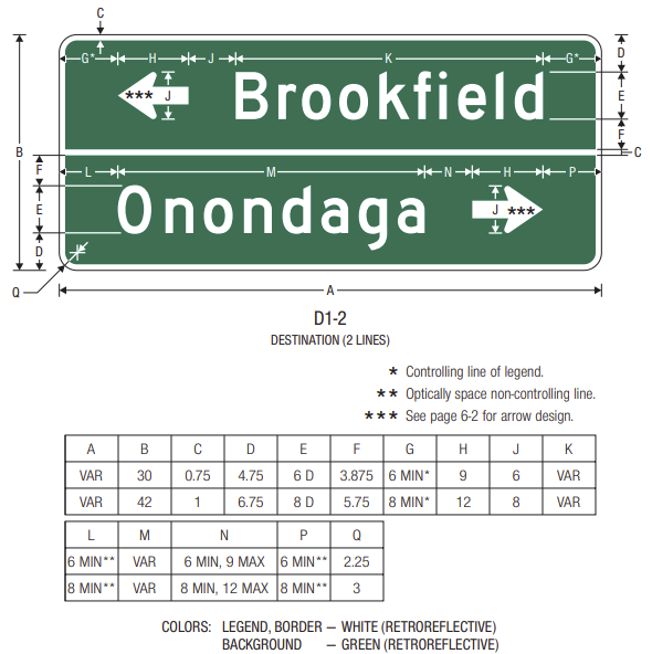

Introduction: The video below shows how-to create a D1-2 Destination (2 Lines) sign in OpenRoads SignCAD.
