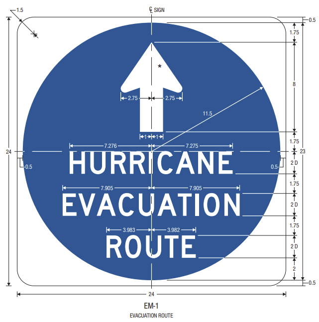

EM-1 Evacuation Route Sign
Product:
OpenRoad SignCAD 2023
Version:
23.00.00.151
Area:
How-to
Original Author:
Introduction: The video below shows how-to create an EM-1 Evacuation Route sign in OpenRoads SignCAD.
