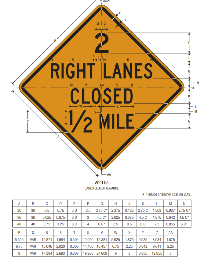

Introduction: The video below shows how-to create the 30" W20-5a Lanes Closed Advance sign in OpenRoads SignCAD.
