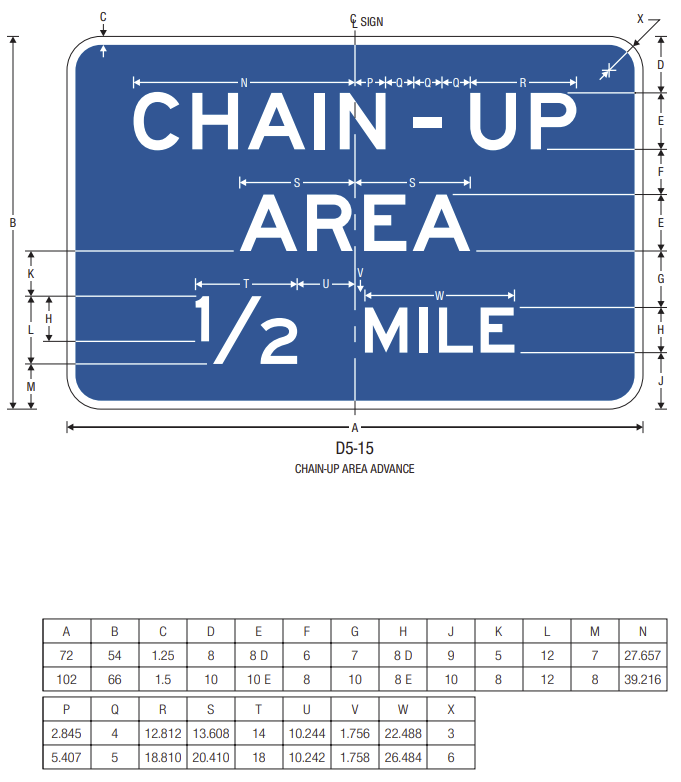

D5-15 Chain-Up Area Advance Sign
Product:
OpenRoad SignCAD 2023
Version:
23.00.00.151
Area:
How-to
Original Author:
Introduction: The video below shows how-to create a D5-15 Chain-Up Area Advance sign in OpenRoads SignCAD.
