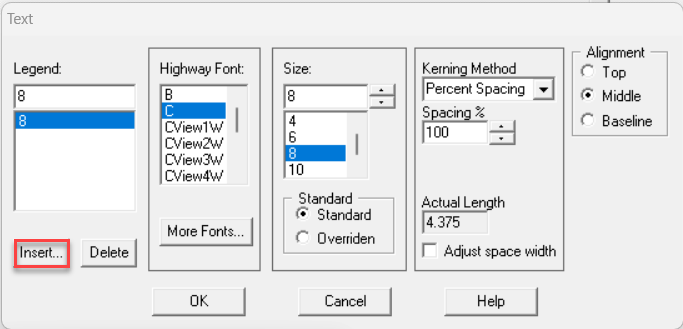

6) Type “8” <enter>. Right click on "8" and pick Edit Data from the floating object menu to bring up the Text dialog box.

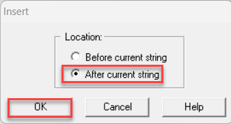

7) Click on the Insert button to bring up the Insert dialog box. Select Location: After current string and click OK.

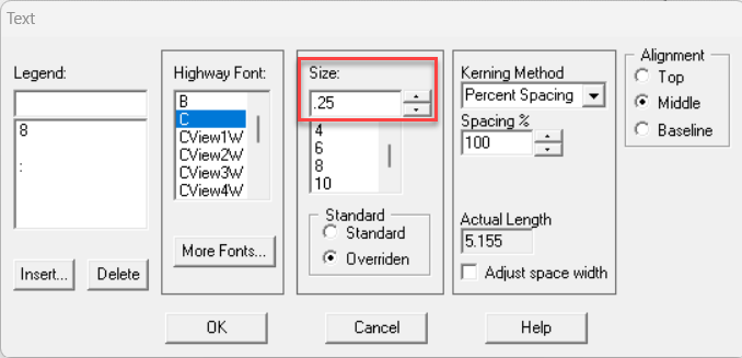

8) In the Legend field of the Text dialog box, press the <spacebar> to create a space after the number “8”. Type 0.25” for the text size.
9) Press Insert and select Location: After current string and click OK.

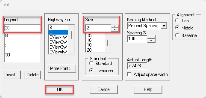

10) In the Legend field of the Text dialog box, type “:” to create a colon after the space. Type "2” for the text size.

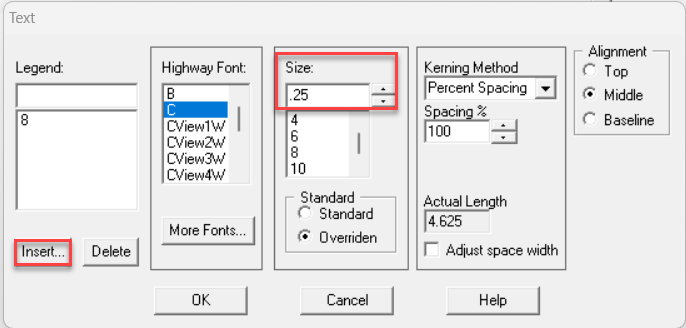

12) In the Legend field of the Text dialog box, press the <spacebar> to create a space after the colon. Type "0.25” for the text size.
13) Press Insert and select Location: After current string and click OK.
