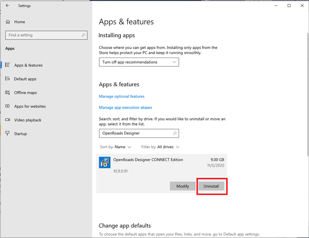

  1. Uninstall OpenRoads Designer through the Systems Settings > Apps & features. Go to Start > Settings > Apps > Apps & features.  You can search for OpenRoads Designer or find it in the list, highlight the program and select 'Uninstall' for Windows to start the uninstall process.

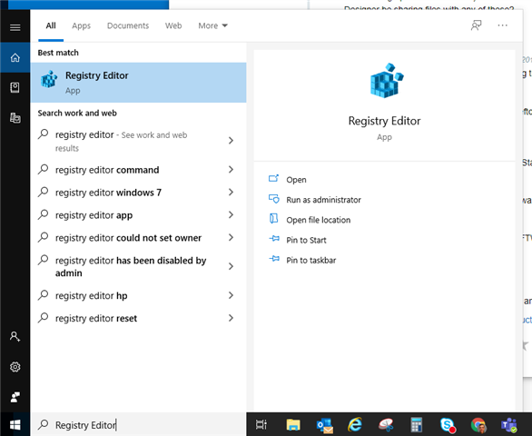

3. It may also be required to clean the registry keys as well to remove any leftover registry items. Note: Be careful to follow these steps and do not delete anything else from the registry.
Open the Registry Editor by searching for the 'Registry Editor' App.
Go to HKEY_CURRENT USER\Software\Bentley and delete the OpenRoadsDesigner key.
Go to HKEY_LOCAL_MACHINE\SOFTWARE\Bentley and delete the OpenRoadsDesigner key.
