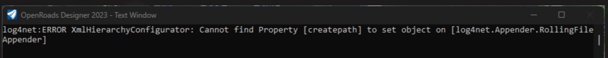

log4net:ERROR XmlHierarchyConfigurator: Cannot find Property [createpath] to set object on [log4net.
Product(s):OpenRoads Designer
Version(s):10.23+
Area: Startup
Question:
When launching OpenRoads using a clients workspace, an OpenRoads Designer text window displays the following error:
log4net:ERROR XmlHierarchyConfigurator: Cannot find Property [createpath] to set object on [log4net.Appender.RollingFileAppender]
Answer:
This is most likely caused by a configuration variable from the clients workspace pointing to a path that only exists inside their organization.
For example, check the MS_USERPREF variable and verify that it is a valid path.  In the example below, the workspace was created by 'xdot' and functions properly for its users, but for consultants outside the DOT, the path is not valid.
MS_USERPREF    = c:/xdot/users/prefs/ORD_User_Preference.upf
