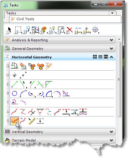

When I use the Import Geometry tool and select a file to import
the dialogue box is blank
It should look like this.
How to resolve?
Answer:
Below are a few things we would normally check for in support.
  1. Ensure that you're importing a supported file format
  2. Ensure that the file resides in a directory that you have read/write access to.
  3. Ensure that the file is NOT read only.
