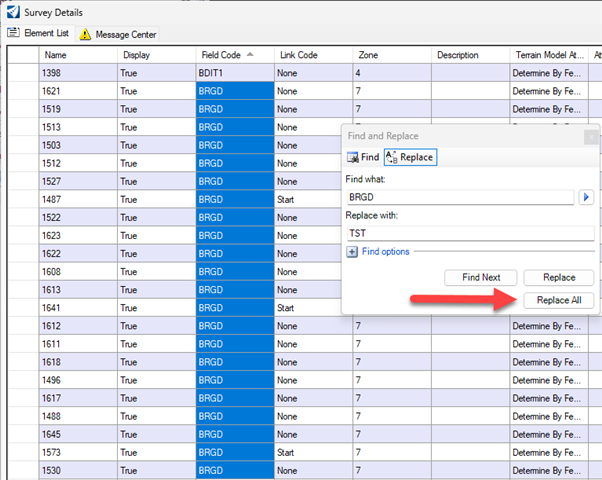

My goal is to be able to change all the codes for a set of points at the same time. I imported a field .txt and included some wrong code: I can edit one by one and change them, but is it possible to change all the codes for all the points at the same time?
Answer:

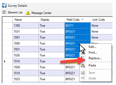

In survey details, you can select all the desired field codes then hover your mouse over that column and right click with your mouse and choose replace.
After this you simply need to enter the desired field in the Find what section and key in the replacement field code in the Replace with section of the dialogue and press replace all.
