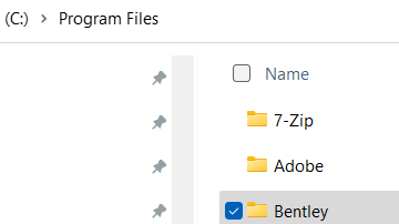

2) This has been reported with users who have the security virus scanner Sentinel, SentinelOne, Sophos, or Cylance. If you are using a security virus scanner, then you will need to whitelist the Bentley folder so that the OpenRoadsSignCAD.exe is not blocked. The default path is under C:\Program Files.

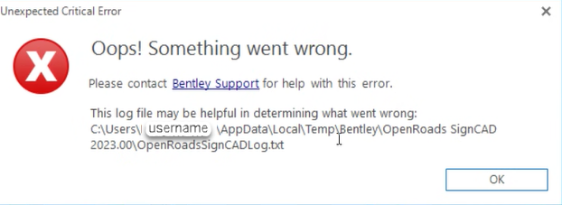

5) If you receive an "Unexpected Critical Error" when launching OpenRoads SignCAD, please create a case and upload the OpenRoadsSignCADLog.txt file and Event Viewer logs for review.
