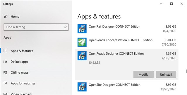

8.  Try a clean uninstall\reinstall of the software.
Watch this video

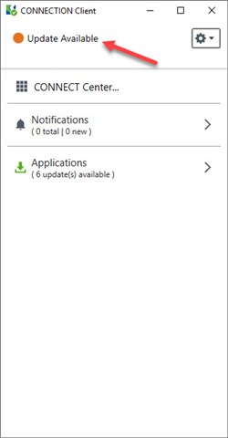

9.  Update your Connection Client to the latest version.
Connection Client Preferences and Settings WIKI

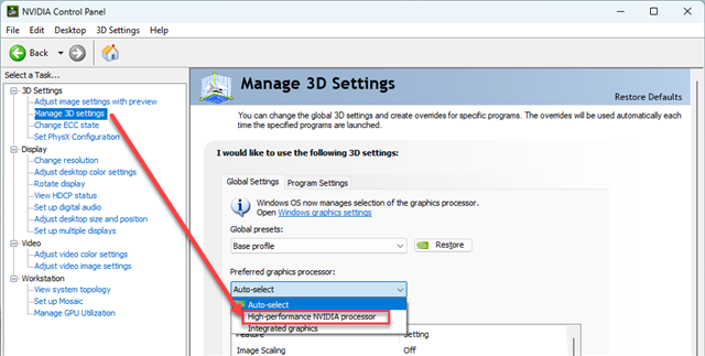

14. If you open the windows resource monitor and notice a spike in memory before the crash, try changing the preferred graphics processor, reboot your computer and attempt to open the dgn again.
This wiki has more information.
