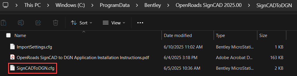

1) Copy the SignCADToDGN.cfg file found in the C:\ProgramData\Bentley\OpenRoads SignCAD 2025.00\SignCADToDGN folder.
NOTE: If the ProgramData folder is hidden, go to View > Show and toggle on the option for Hidden Items.

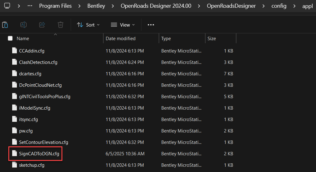

2) Paste the SignCADToDGN.cfg into the product config\appl folder for MicroStation, OpenRoads Designer, OpenRail Designer, or OpenSite Designer.
NOTE: The MicroStation or OpenX product version does not need to match the version of OpenRoads SignCAD being used. Example: You can use the OpenRoads SignCAD 2025 SignCAD To DGN application in OpenRoads Designer 10.12, 2023, 2024, etc. However, the SignCAD To DGN application will not work in V8i products.
Example OpenRoads Designer Path:
C:\Program Files\Bentley\OpenRoads Designer 2024.00\OpenRoadsDesigner\config\appl

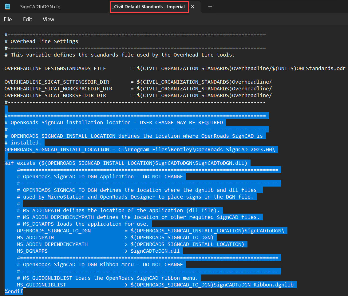

WORKSPACE CONFIGURATION

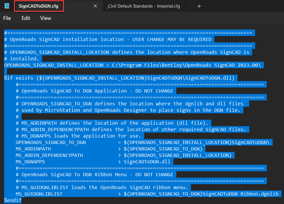

Copy the contents of the SignCADToDGN.cfg and paste them into the _Civil Default Standards - Imperial.cfg or other WorkSpace .cfg file located under the OpenRoads Designer Organization-Civil folder.

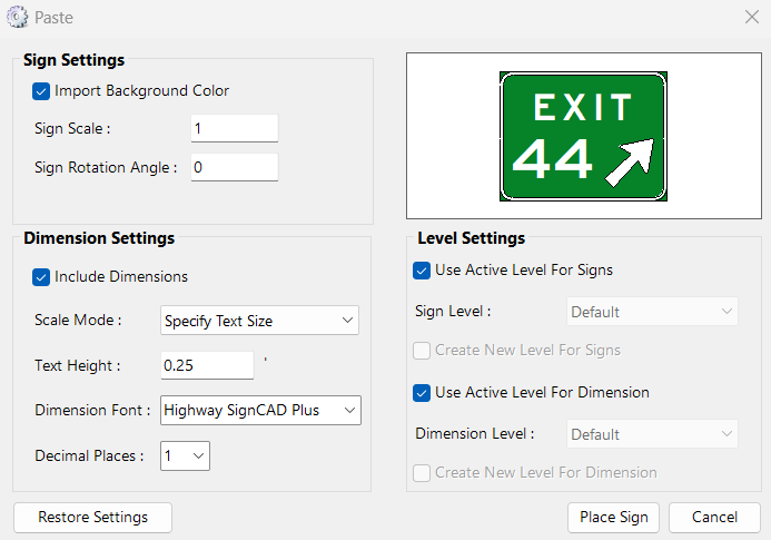

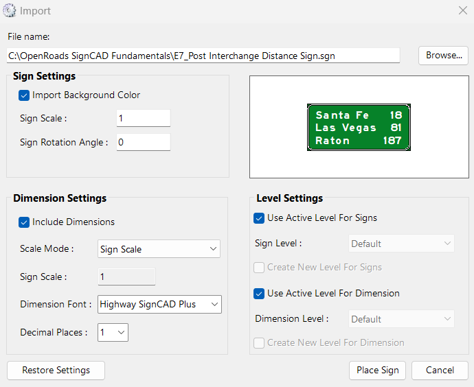

The OpenRoads SignCAD ribbon workflow includes icons to Import SignCAD File or Paste SignCAD File into the DGN file. The OpenRoads SignCAD 2025 version has a new Batch Import option.
Import SignCAD File – Browse to select SGN file to import into the DGN file.
Paste SignCAD File – Paste sign from the clipboard into the DGN file. To add a sign to the clipboard, select the sign in OpenRoads SignCAD followed by Copy (or CTRL-C).

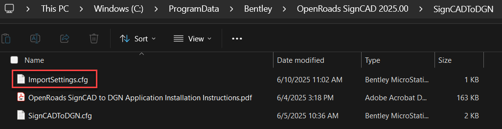

HOW TO DEFINE THE DEFAULT IMPORT SETTINGS (OpenRoads SignCAD 2025 and 2024)
You can define the default import settings in the ImportSettings.cfg file located in the C:\ProgramData\Bentley\OpenRoads SignCAD 2025.00\SignCADToDGN folder. Edit the ImportSettings.cfg file in Notepad and save your changes.

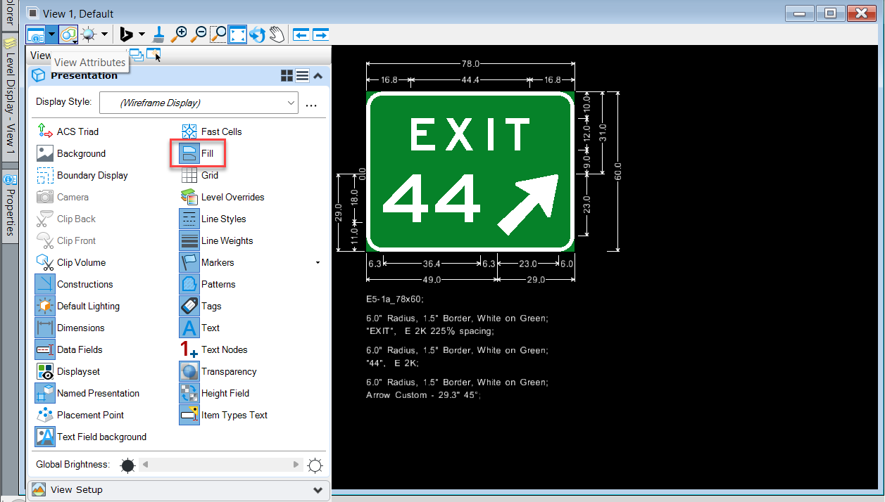

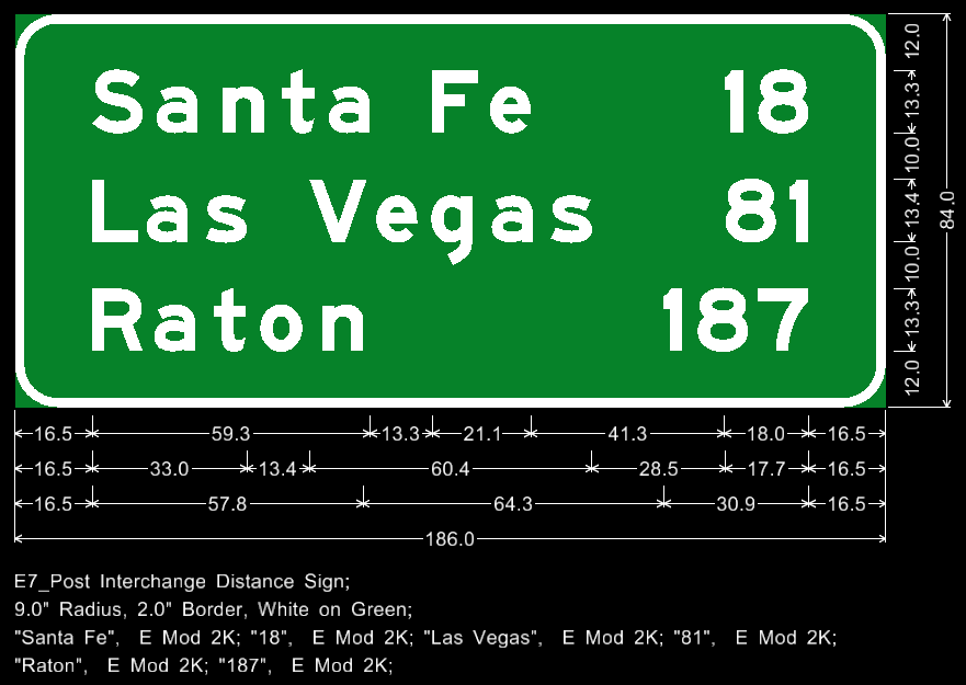

IMPORTANT: If you have the Fill Color (2023 SignCAD To DGN) or Import Background Color (2025/2024 SignCAD To DGN dialog) boxes checked in the Import or Paste dialogs and the placed signs do not display with the color fill, then check the View Attributes in OpenRoads Designer or MicroStation to make sure that Fill is toggled ON.
View Attributes>Fill toggled OFF
View Attributes>Fill toggled ON
