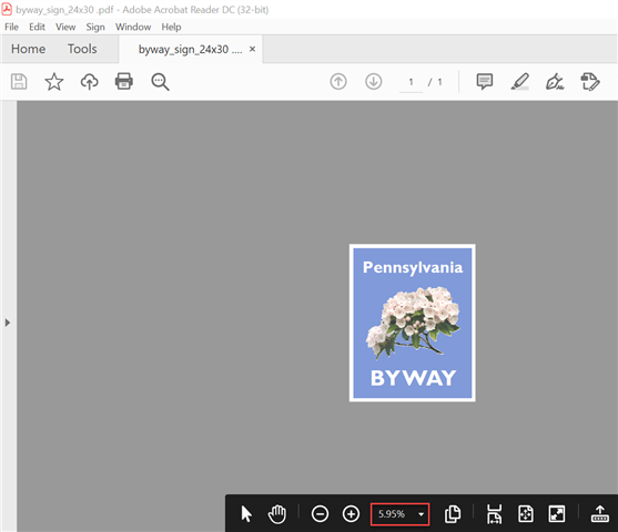

1) Open the pdf in Adobe Acrobat Reader.

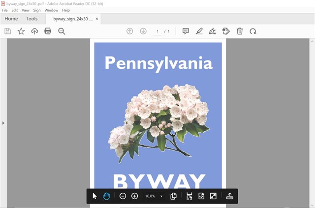

2) Use the Zoom In and Zoom Out tools or enter a scale percent to get the desired image size.

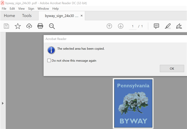

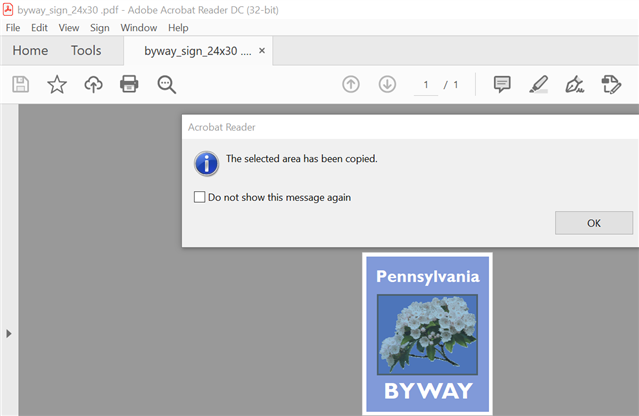

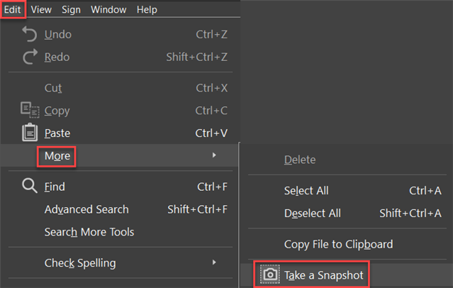

3) In Adobe Acrobat Reader, pick Edit>More>Take a Snapshot and select the portion of the pdf you want to copy. The selected area will be copied to your clipboard.

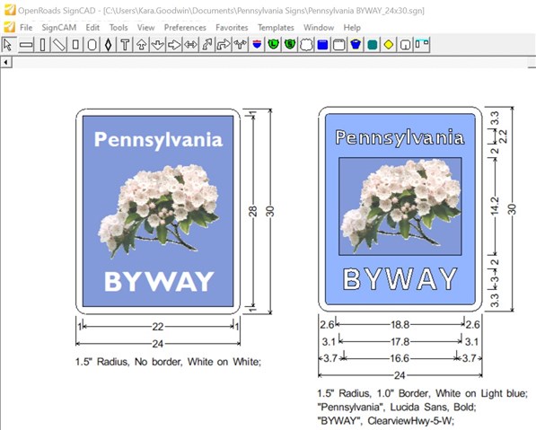

4) In OpenRoads SignCAD, pick Edit>Paste. Select and drag the image onto the sign panel and adjust object spacing as desired. NOTE: There is not a way to round the corners on the image or to remove the box around the image in OpenRoads SignCAD. The sign on the left shown below is an image on a white panel. The sign on the right is a light blue panel with a white border and text that has the mountain laurel flower image added.
5) Save the file (File>Save As).
