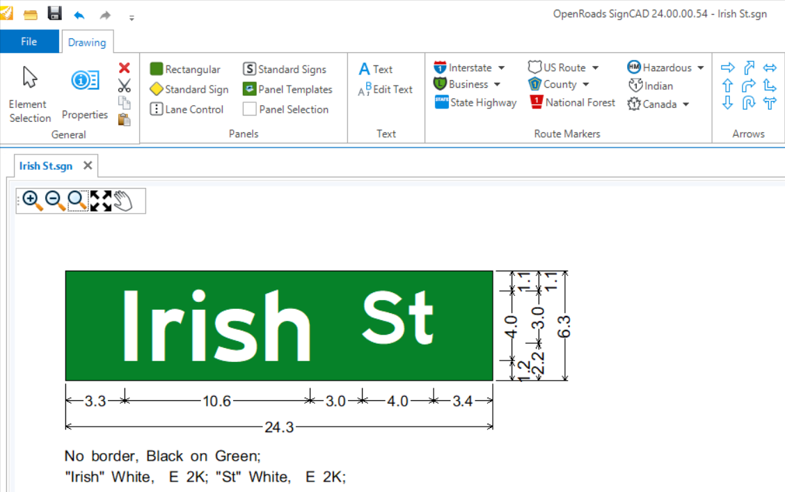

Step 1: In OpenRoads SignCAD, create a new file or open an existing file to import the bitmap (.BMP) image file into.

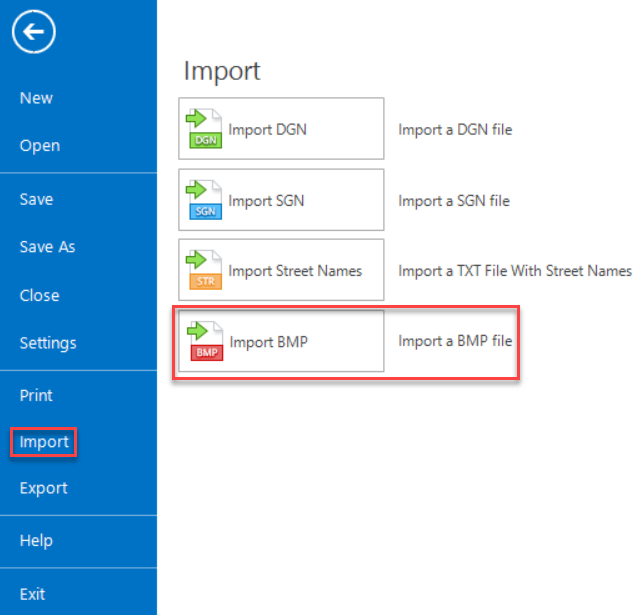

Step 2: Pick the File tab to go to the Backstage and pick Import > Import BMP.

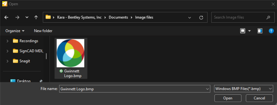

Step 3:  In the Open dialog, browse and select the BMP file to import and press Open.

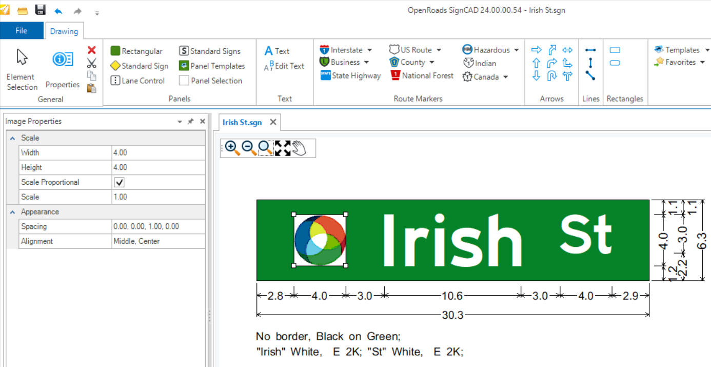

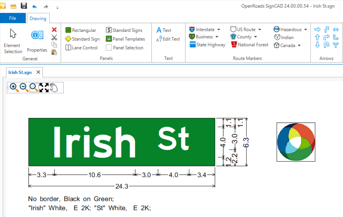

Step 4:  The imported bitmap image will display on the workspace, and it can be added to a sign panel if desired.
Step 5: Select the image and pick Properties. The image can be resized in the Image Properties.
