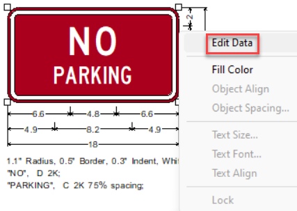

The Rectangular Panel  and Lane Control Panel  tools have a Custom tab that allows you to choose which panel edges to display or remove.
1) Right click on a panel and pick Edit Data.

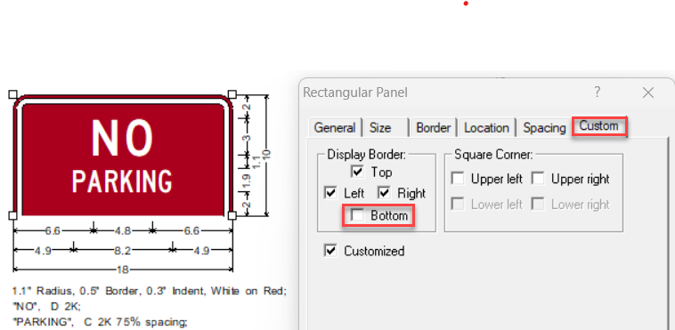

2) In the Rectangular Panel dialog, pick the Custom tab. Under Square Corner, check any corners to square. Under Display Border, uncheck the border(s) to remove. Press OK.
