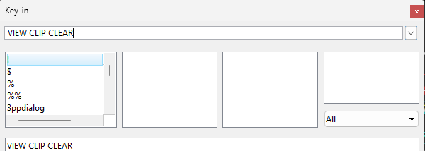

Clearing the clipped view can solve this problem. There are two ways to clear the clipped view:
  1. You can use Key-in VIEW CLIP CLEAR and click on the screen and it will fix the issue.
  2. Using the tool clear clip volume in Clip Volume
    Once you select the tool you will have to and click on the screen and it will fix the issue.
    Attached video below demonstrate the steps.
