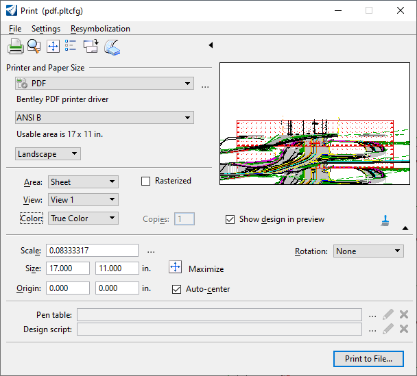

Cross Section Sheets not printing correctly
Product(s):OpenRoads Designer, OpenRail Designer, OpenSite Designer
Version(s):CONNECT
Area: Printing, Cross Section
When I print cross section sheets they appear as shown below.

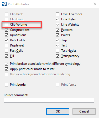

Within the print dialogue, go to Settings>Print Attributes and toggle on Clip Volume.
