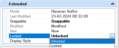

Not able to edit table values and table headings are missing in ORD
Problem Description
Not able edit the values in tables and the table headings are missing.
1. Open the Properties Dialogue
2. Select the table which is locked
3. Expand Extended in Properties
4. Change Locked to Unlocked
If the table is still not editable then follow the below steps
1. Click on element selection tool
2. Select the table
3. Click on Disable Handles
