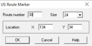

  1. Pick the U.S. Route shield icon and click on the workspace to bring up the US Route Marker dialog box. Enter Route number: 30 and Size: 24. Press OK.

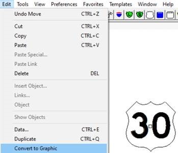

2. Select the route marker using the Select tool and pick Edit>Convert to Graphic

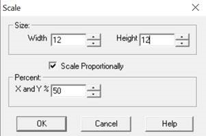

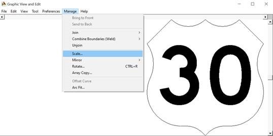

5. In the Graphic View and Edit, select Manage>Scale.
6. In the Scale dialog box, change the Size to 12 for the width and height. Press OK.

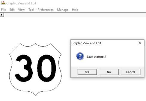

7. Pick File>Close and press “Yes” to save changes.

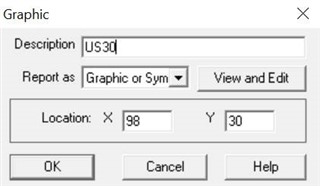

8. In the Graphic dialog box, enter a Description (ex: US30) if desired and then press OK.
9. The US30 graphic is now 12” and can be placed on a sign panel.
