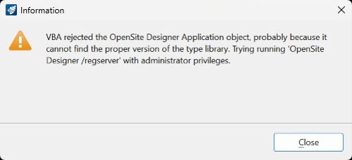

Received following message.
VBA rejected the OpenSite Designer Application object. probably because it cannot find the proper version of the type library. Trying running 'OpenSite Designer /regserver' with administrator privileges.
VBA Rejected Error
