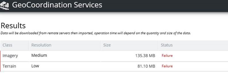

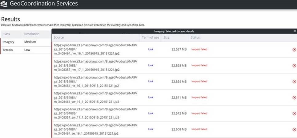

"Failure message" while importing data from GeoCoordination Services
              Product(s):
OpenRoads ConceptStation
Version(s):10.00.00.108+
AreaGeo coordination Services

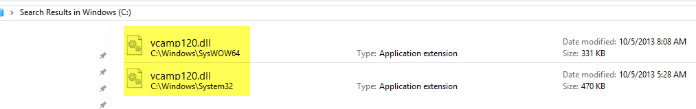

Problem Description: Failed to Import Data by using GeoCoordination Services as it throws failure messages.
1. First check the following dll which should avail on your system, Path of my system (on windows10) as shown below.
 2. If dll are missing on your system, then we need to install Microsoft Visual C++ Redistributable packages for Visual Studio 2013 as the dll is a part of the Microsoft Visual C++ Redistributable Packages for visual Studio 2013.

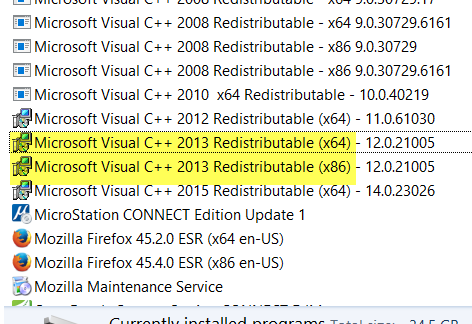

3. To download Microsoft Visual C++ Redistributable packages, please refer the following link.
https://www.microsoft.com/en-ca/download/details.aspx?id=40784
4. Installed Microsoft Visual C++ 2013 Redistributable packages in control panel will be looked as shown below:

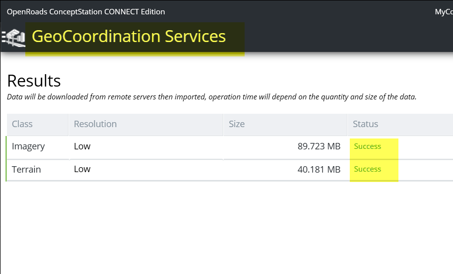

5. Then after, try to import data by using GeoCoordination services which will show "Success" as shown below.
