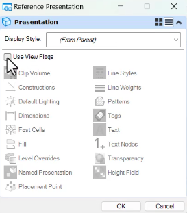

Not able to edit Nested reference setting
You need to set configuration variable MS_LEVEL_EDIT_NESTED_ATTACHMENT_LEVELS=1

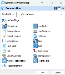

Click on Use View Flags
And you will be able to edit now
