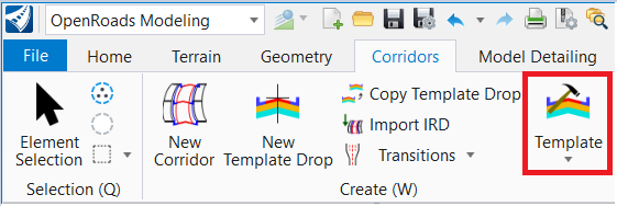

Go to OpenRoads Modeling > Corridors > Create > Create Template.

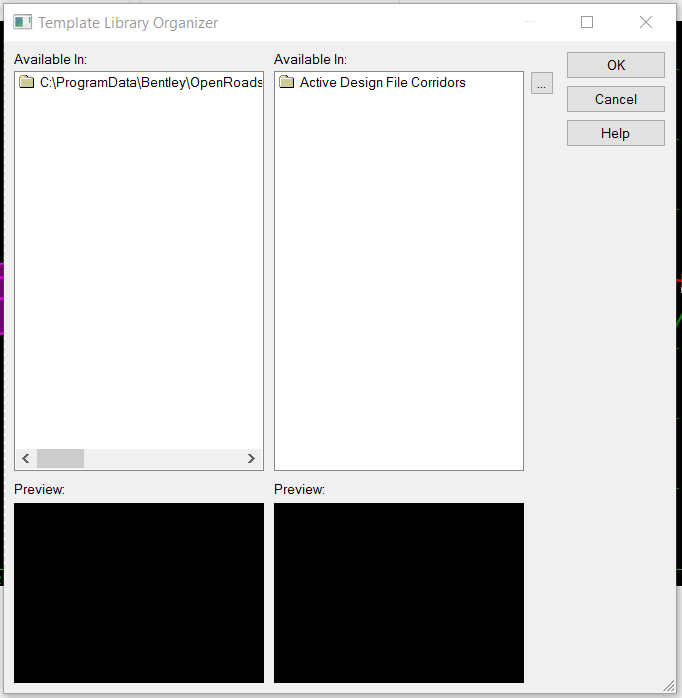

Go to Tools > Template Library Organizer.

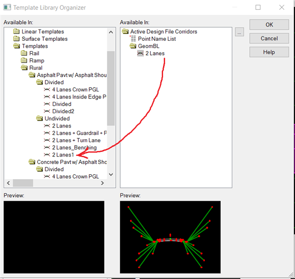

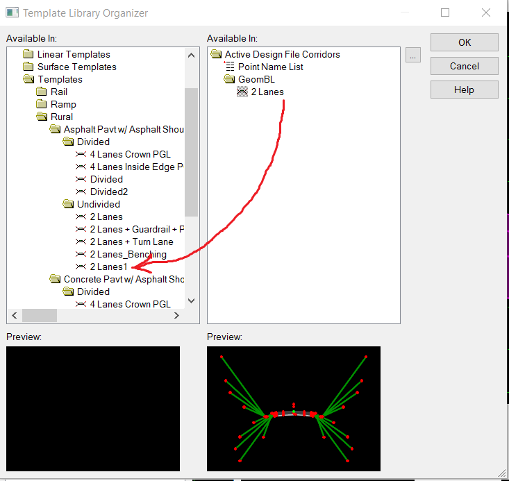

Select the Template you want to move to the Template Library within the Active Design File Corridors (Right Column) and drag it to the desired location within the itl (Left Column)
Click Ok.
From there you can make changes such as deleting the original and renaming the one you placed in the Template Library.
